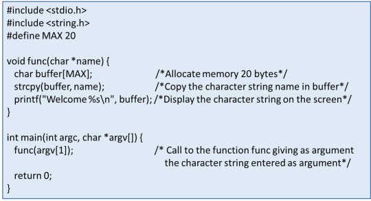

The example below illustrates how a stack overflow can occur (see figure 2). Consider the following code written in C language, which copies the contents of the parameter entered via keyboard into the local variable of the func function, called buffer, which has a memory length of 20 bytes. The func function prints on the screen the message "Welcome <name>", where name represents the string entered by the user from the keyboard:
Fig. 2. Example of stack overflow
In this case, the program lacks a verification to ensure that the length of the string entered by the user does not exceed 100 characters. This opens the door to a stack overflow, since the reserved stack size (100 bytes) is exceeded, resulting in writing to previously unreserved memory areas. This inappropriate writing can result in changes to the contents of these areas, possibly causing errors in program execution. With this vulnerability, an attacker could insert malicious code (so-called shellcode) into the buffer, overwriting the return address of the function to point to the start of the buffer. The shellcode consists of a set of instructions written in assembly language, a low-level language that allows specific tasks to be performed. This enables attackers to execute arbitrary code in the compromised application. It is worth noting that the assembly code used has to be created by the attacker in a way that it is compatible with the system under consideration.
